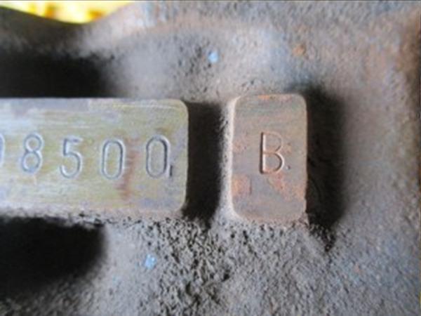

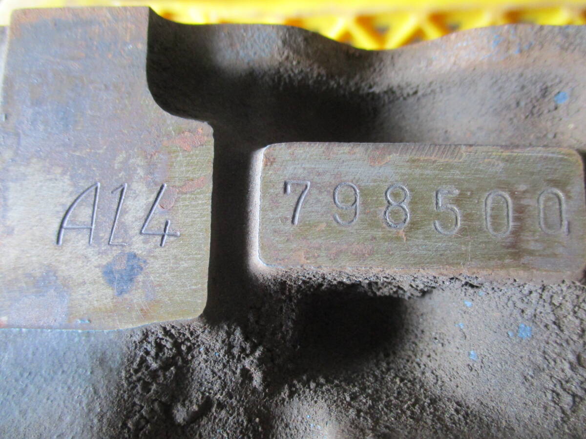

A14 cast "A14" above fuel pump

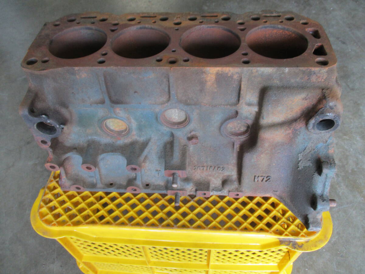

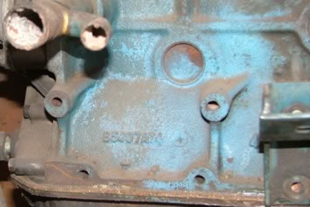

H72 Casting mark with "29027A03" cast mark
H72 with "28X23A01" cast mark
18284_557bb0637cead.jpgPost 469285

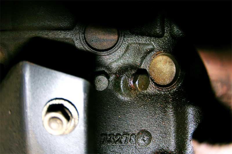

G34
Late A14/A15 casting 'G34'.
  • Different from the earlier #H97 A15 block
  • #A14 from 1980 used this rationalized block.
