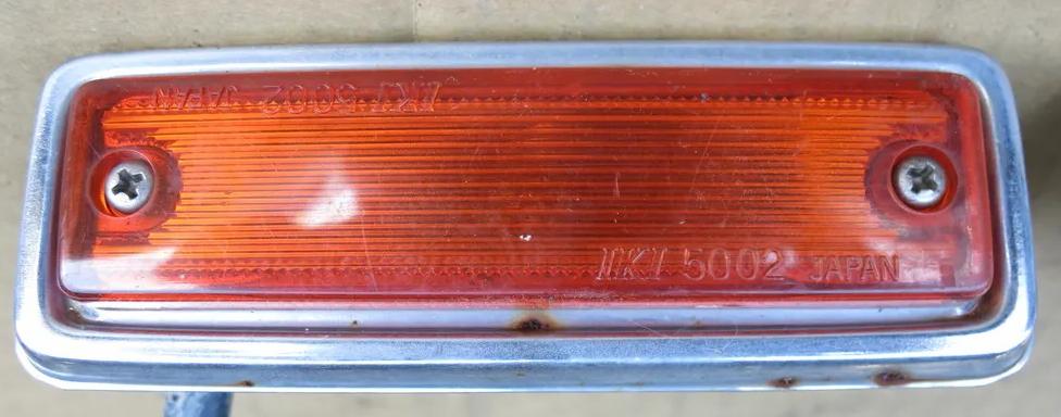

Chrome Type
26160-H1001 LAMP ASS'Y-side flasher -7803 [chrome rim]
'IKI 5002 JAPAN' | 'B-110 45 TOKYO'
20764.jpgAlbum 20764 20763.jpgAlbum 20763 12063.jpgAlbum 12063
4099.jpgAlbum 4099 3812.jpgAlbum 3812 8456.jpgAlbum 8456
* integrated two-wire harness (bulb 12V + earth/ground)
26161-H1001 LENS -7803 [marked 'IKI 5002 JAPAN]
26162-H1001 RIM -7803
