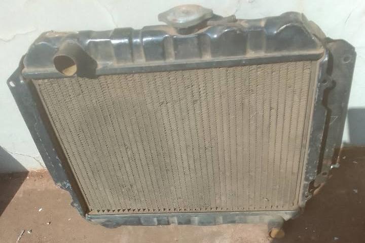

B110 radiator has 20% more cooling capacity than B10 unit, yet and same weight. The capacity increase was intended for high speed running.
GX Radiator 21400-H2300 (3-core)
