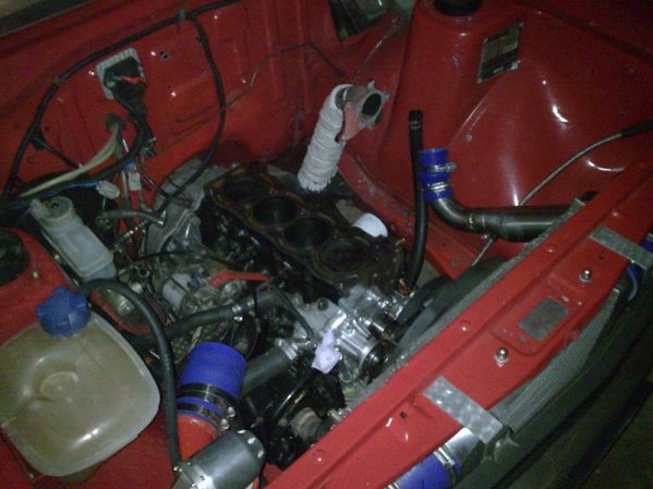

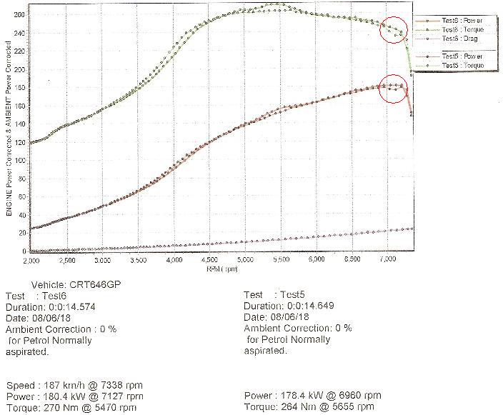

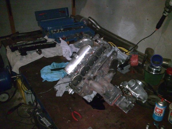

So it went for the dyno, but with the first power run, it spat out it's coolant(178.4kw). Filled it up, and ran it again, same thing(180.4kw). Opened her up on Wednasday evening, and found that the gasket failed. Head was still straight. So it made pretty good power even though the engine wasn't realy at it's best.

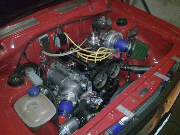

So tonight Thursday, she was put bakc together again. Fired up first time when coil wire was connected, after oil pressure was detected. Some pics of the proccess.
Note in last pic some upgrades. 50mm boost pipe between turbo and coller replaced with 67mm item. New 58kv coil, unfortunately no more Fanta injection(probably why it failed), and yellow Mallory 8mm plug and coil leads. I took half of a V8 set another guy with 4 cylinder bought, the Coil wire was made up from off-cut from one of the plug leads...
Also note in dynograph above, the red circles indicate dip in power right when it pukes it's coolant...

Is this kw at the wheels or an estimate of kw at the engine? edit: or both?
kululadotgroen
Posted: 2008/6/20 6:36  Updated: 2008/6/20 6:36
Joined: 2006/7/12
From: Cape Town ZA
Posts: 1054
 Re: New dyno chart
At the wheels, the dyno guy says it's the most accurate, as he's not guessing what ratios your gearbox or diff has, and it's the figure that actually matters. Unless he's lying, but it sure does feel like that...
Tyrie
Posted: 2008/6/20 6:47  Updated: 2008/6/20 6:47
Joined: 2004/5/4
From: Canberra
Posts: 4200
 Re: New dyno chart
yeah I assumed it would be, just the "ENGINE power corrected" got me wondering.
Solid power out of the little 1.6 anyway :) well done.
kululadotgroen
Posted: 2008/6/20 7:08  Updated: 2008/6/20 7:08
Joined: 2006/7/12
From: Cape Town ZA
Posts: 1054
 Re: New dyno chart
Ah I see what you mean, but seeing as my car made close to the same amount on the dyno 1500m higher from sea level, and that was wheel power, it must be wheel power on this too. I'm just wondering why that is there, if it's a standard heading or something. I will find out and post what he said.
