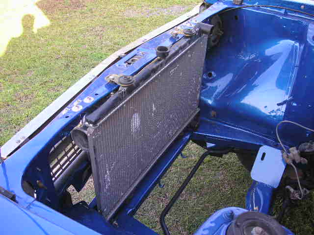

Have you got a shot of how your intercooler is hooked up? Also that's a crazy looking air filter!

Mildman.......
What are you specifically looking for?
The intercooler plumbing into the cooler, or the cooler mounting to the body?

Just interested to see where you located the cooler (so mount to the body).
I'm about to drop in my CA, I've got a stock cooler, but am thinking of going bigger but wonder what to mount and where to mount.
If that makes any sense...

Some approx. 100 x 8mm bolts down through where the radiator mounts.
Cut some 10mm SS tube to get the required mounting height.
The bottom mounts are 90 deg brackets attached to the seam running off the front square section engine bay cross-member.
Here's a photo - Hope it helps: -

Cool - nice coops.
What size is the intercooler again?
Seems to be the way to do it (mount infront of the radiator that is).
Might have to buy a bigger I/C (than the stock one) - depends on how much the piping would be to change if I start with the stock and move into a bigger one later...

450 x 600mm.... I think.
Much bigger than that & you have to start cutting into the nose cone.
