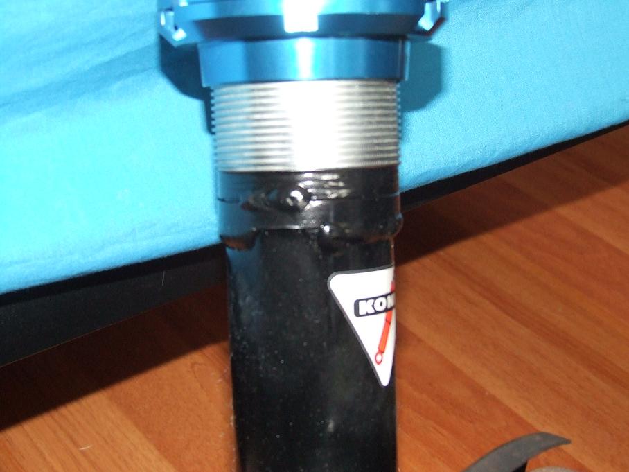

just some pics of it completed.

B120dat, nice work, looks great, what spring rate and length did you go for?

hey fellas...the spring rate is 175 pound, hopefully that should be just about rite. The springs measure out to about 25cm in lenght.
Really happy with the work that old mate did, will put them in this week some time.
Im pretty sure the bump stops are cut down commodore ones, there pretty aggresive ones. there stanza struts.
should have 40mm travel when in car from bottom of bump stop.

40mm of travels not a great deal ??!! the weight of the l series on 175lb springs and 40mm ..... bump stops look quality tho

Narh there should be heaps of travel, I think he mentioned they had that much travel maybe more then. Yeah if and when i upgrade my motor will change the springs out, but lots more goodies to do yet on the ute

Just pic of my front suspension setup
Ajustable koni's, Ajustable tops with German bearings, stainless nuts/studs and bearing support and threads (annodised blue), 60mm shortened strut, 175pound king spring...
Also all new tie rods and ball joints. Also gave the calipers a nice spray of red
cheers
Also a pic of the slevee and there was a set up for the threads.... really good work!
