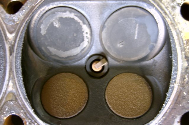

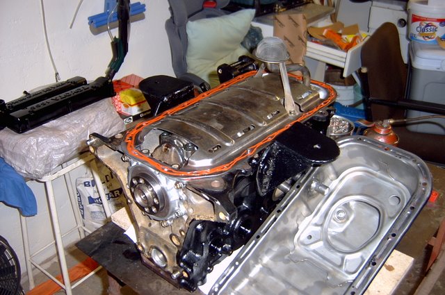

We put the engine back together about 3 weeks ago now, and it runs like swiss clockwork. Have taken the boost up to 8 psi again, and so far it's holding up. Kicked some ass while I was at it too... It should go for a dyno this week, or early next week, depending on what happens with some job interviews I have coming up...
Here is what the chambers looked like after taking the head of, they all looked like this, so the engine was running well, except for that bearing that gave up of course...

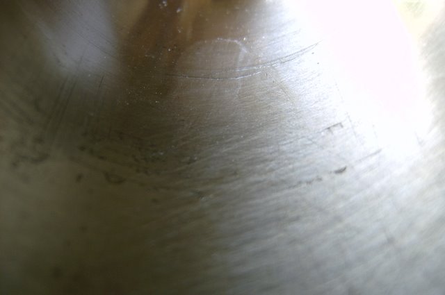

And the number one cylinder seems to have taken on some water before I got hold of it. Must have been when they shipped it, or it was standing out in the rain. The engine never used any oil, or smoked for 8 months, so I figured that it should be ok to just give it a good hone, and use it like this again. It's not smoking now either, so my gamble was ok... saved me R4000 for a new set of pistons anyway...
And last but not least just an assembly photo...
