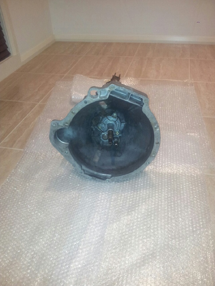

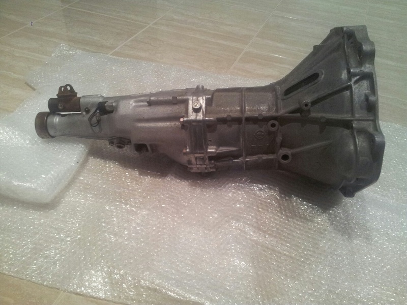

Just arrived from Japan.Will be used in the coupe.
Nismo close ratio F5C56A.Dogleg shift pattern.Direct fifth-gear.
This gearbox was kept as a spare for Competition use only.
Will Help reduce rev drops during gear changes and keep the a12 1300cc on its power band.
On track,Less time to switch btw 2nd and 3rth,4th and 5th due to dogleg pattern.
Should compliment my nismo 2 way H165 4.875 diff well and help aid acceleration.
will get different diff ratios for different tracks.
Gear ratios:
1st 2.676
2nd 1.691
3rd 1.398
4th 1.181
5th 1.000
Rev 2.877
