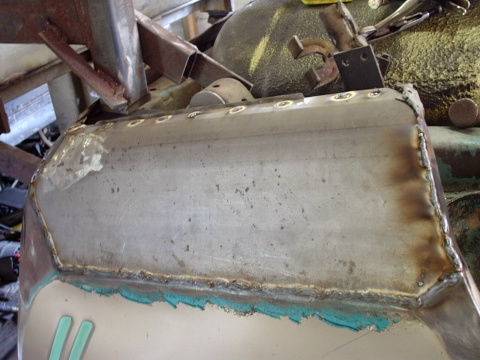

Weld it up (short welds about 2in long,weld back to the weld you just done if you are left handed start on the right side[ viser versa] ) but wait for it to cool down a bit before next 2in of weld to slow down distorions

Was that EZY?Yep for me it is same way to do S/Steel sheet
