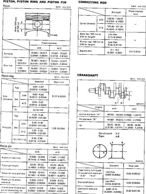

I dont get how it says that the standard oil ring is combined??
Good drawings i say!
