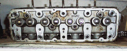

i need help identifying this head, the head has big water holes and oval ports, but dont have cast number.

the pics are a bit small but i would say it is a A12 GX head as they had NISSAN cast in the top only,other heads had cast numbers.??????.GREG

From here it also looks like it has double valve springs, thus rendering it a GX head as no other A series heads had them.... Im with greg on that, GX also had the NISSAN casted on top and no other had this lettering on there

The nissan comp heads have like lumps betwee the head bolts and the wee bits above the manifold studs, overtop of the intake ports. I think it must be more material to allow for even higher porting.
I agree that this is a GX head.

Be careful, many standard heads have been fitted with dual valve springs. So having dual springs doesn't make it a GX head, but is one indicator.
DatsunSSS, A14 and A15 heads are the same, but are not GX heads, which come from 1971-1973 B110 GX cars.

Having seen the larger pictures this is 100% A12GX.Nissan cast in head is a possitive.Oval ports,double springs,and large water holes are also found on A15&A14 heads.The head studs cast with the number 13 is another giveaway.GREG

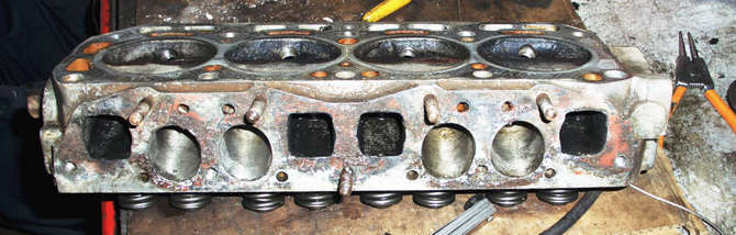

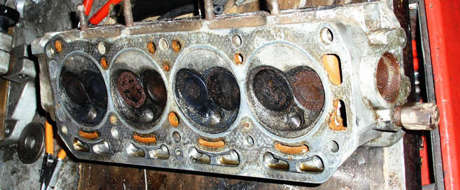

The gasket is a14 or a15 cos they have a smaller size oval port than the a12gx
If the ports are the same size as the gasket, then it is prolly a a14. The a14 and a15 engines have three small holes under the inlets. two at one end and one at the other pair of ports. The a12gx head has four larger water holes under the ports.
The head bolts with the number 13 were used on a12gx engines and all a14 and a15 engines as far as i know. The best way to tell is to take it off and clean it right up so we can see all of it without any gunk or gaskets
I reckon its a a14 or a15 head.

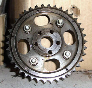

and why the pulley is different?

Ok that is the same head I got from nissan comp it is an a12gx head. appears to have been ported some and possible larger valves, looks like there almost touching. one thing to note it has the oil passage hole same as a12 that later engines did not

the timing gear has been modified to adjust cam timing during set up definatly not a stock engine

In my view, this is a Datsun 1200 GX cylinder head.
I have avoided saying that it is an A12 head as this would then cover the head used on the revised engines in the B210 GX from '74 onwards & the presence of the oil hole on the gasket face rules out these later engines, so Datsun 1200 it is.

I think the same, a12gx and yes as been ported, about 2 mm each side.
