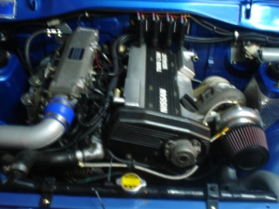

so are you running the jap engine or the supercharger in the ute now. this pic says new engine. you selling?

Love the plumbing setup w/ the pod straight onto the turb inlet.
Very tidy.
It has the ca in it, and the supercharged engine is long gone.

real neat mate... if you dont mind me askin. how much was the mircotech. was it well worth it? i was tossing up between micro and wolf.. and the bosh coils. did they make much difference... i just fouled up my plugs and bought a new coil.. was thinkin of gettin a splitfire setup

Thanks the microtech was $1100 but now there dropped the price to just under a $1000 and the coil and set up works well i have not really tested it yet as its still on the run in tune.

What coilpacks are you using mate? How much clearance is there between the turbo and the strut tower?

Bosch coils and we had to modify the strut tower. So ive got to get a strut brace made.

Are you still running a standard or chipped factory ecu?

Microtech Lt10

Very nice, clean looking conversion mate. Well done.
