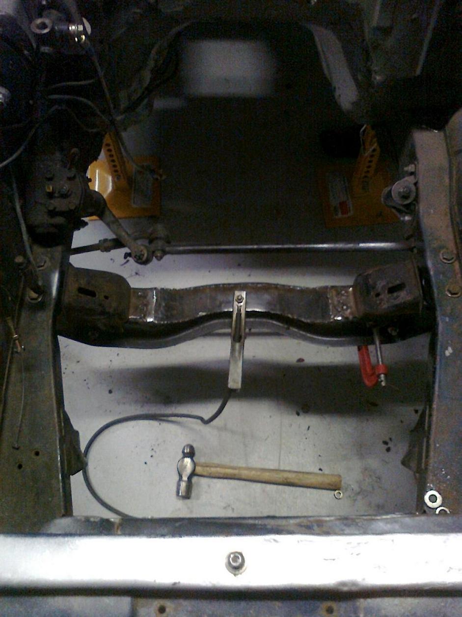

Xmember bolted in wagon and set up motor where i want it clamped mounts and used a couple small self tappers to hold them in place checked it again removed donk and started welding it all in place. Hopefully wont get much or any twist as its all bolted up tight. Got the mig on gas now whole new ball game welds are definitely better just gotta get used to it.

Thanks mik, will assume you meant welding No wedding for me buddy HA HA. There all just a series of tack welds Got the gas there but been putting off hooking it up. Will do it tomorrow and finish the X member with some sweet welds once its all mocked and ready, Hopefully.

Well picked up the L18 from depot today (Thanks Supafatto) Notched out a X member and welded a plate back in, so motor can go nice and low. Unpicked the Stanza mounts and just sat them on. going to bolt it all in me wagon tomorrow and mock it all up for ute.
