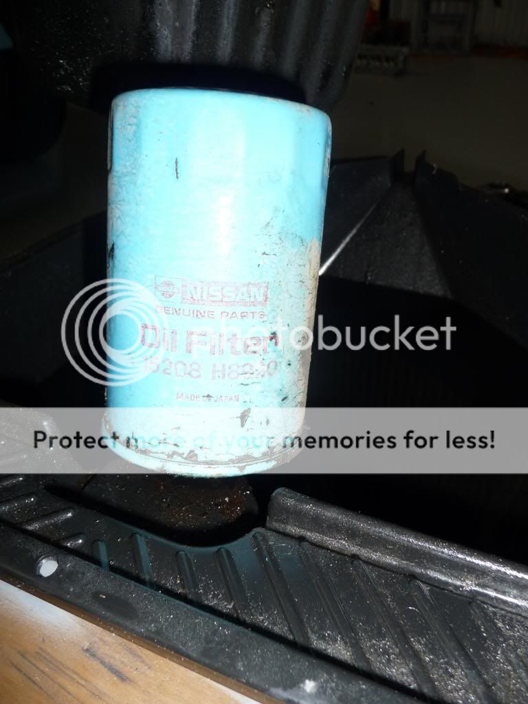

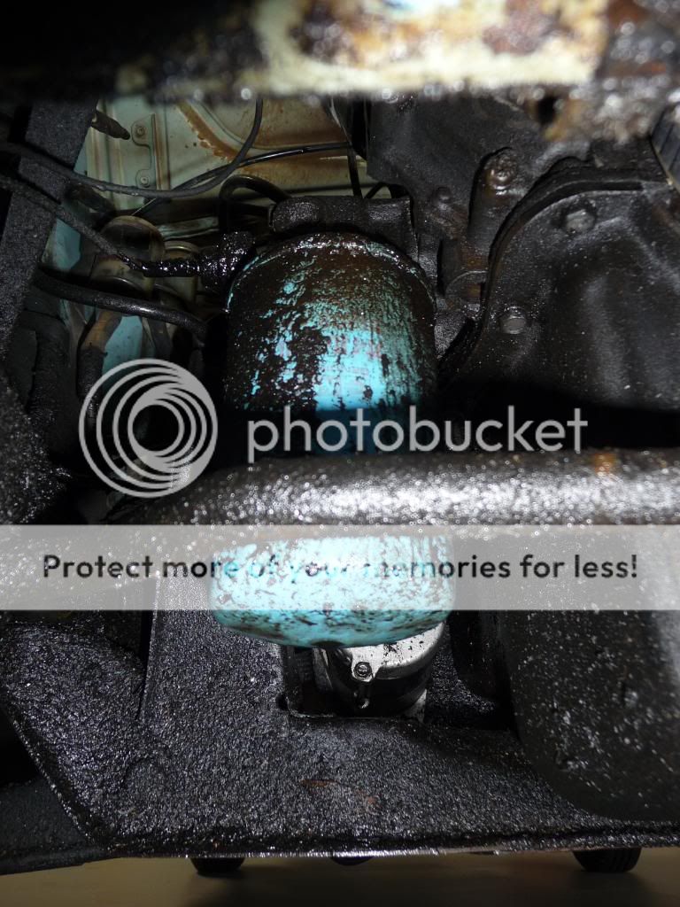

A little distressing information I found out is that the last oil change that Francis received was on the 6th day of janurary in the year 1991.! Terry informed me by this stage Francis had a drinking problem(oil that is), and was drinking 1 pint (600mls) per 1000miles, so he figures just topping up would suffice, and francis never complained.Open in new window
as you can see in this pic Francis is sporting one of the older style long oil filters(genuine)
After removal and a quick degrease (I believe these longer style filters have been NLA for over 10 years)

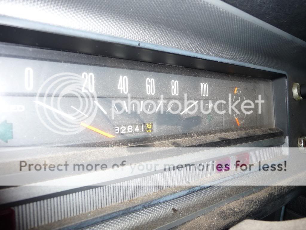

Francis is Terrys' daily drive and together have clocked up 282841miles (455000kms) on this engine. Only having a 100000mile odometer its on its 3rd run around.Open in new window

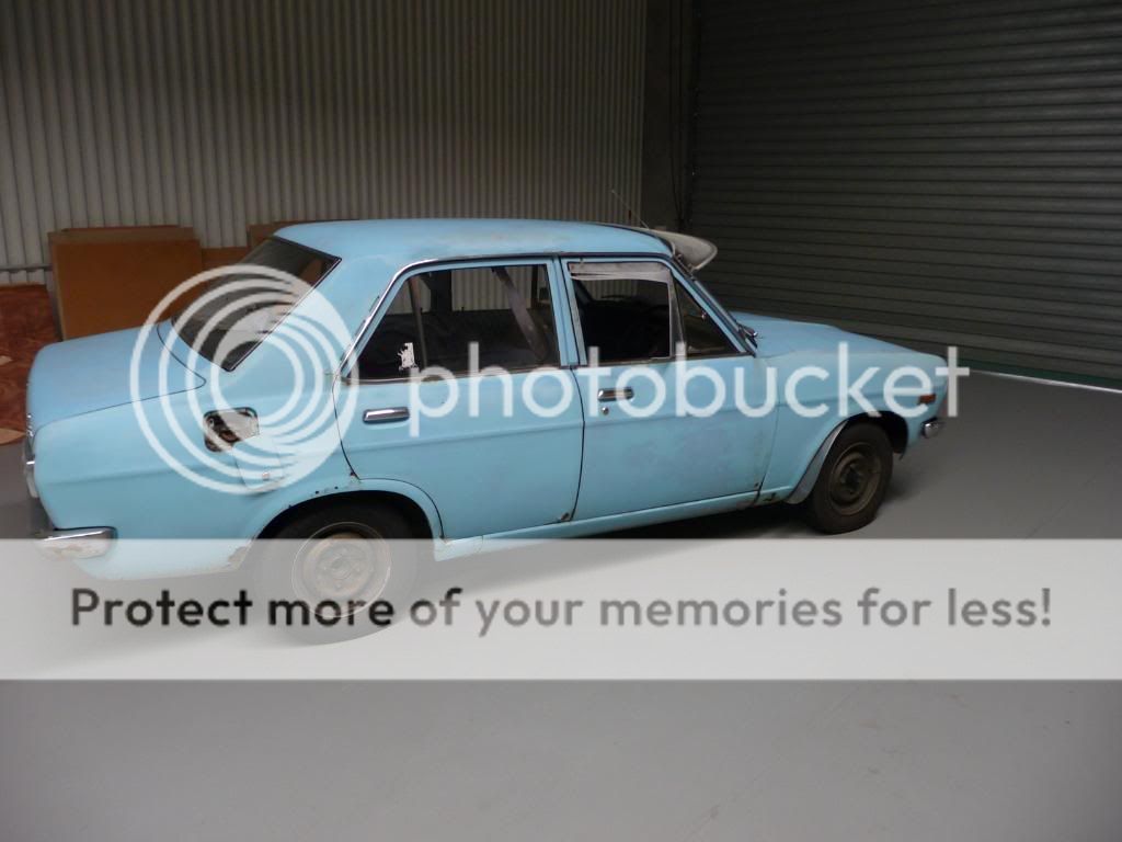

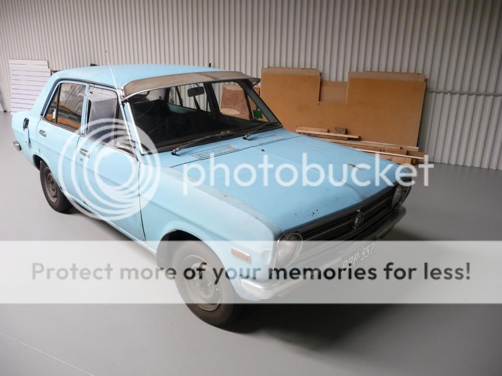

Just want to introduce Francis the datsun to you all.
Francis is owned by a good friend of mine (Terry), who bought Francis brand new in 1970.I'm helping Terry to sort out the issues bought on by Francis' mid life crisis(40 this year). During this 'make-over'I'll relay some of the adventures Terry & Francis have had together, some of the things we find in the make over and some of Terrys' Datsun "facts".
