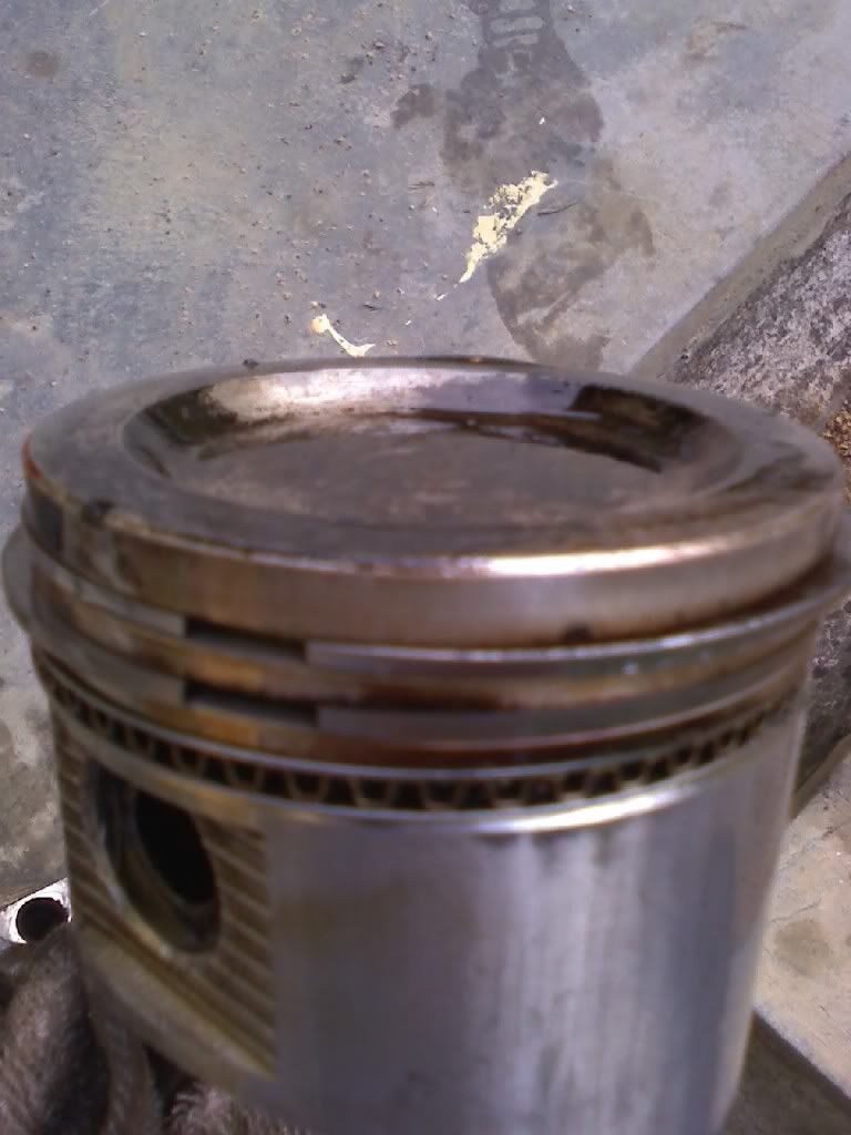

Re: Identify these pistons?
2008/12/12 1:09
From Selangor, Malaysia
Posts: 84
have no idea what piston is that but i dont think its a stock A14's piston,looking from the piston's dish..
below is the pictures of the piston from my A14..hth
and its pretty look like mine (after the piston been shaved)
Posted on: 2009/12/8 9:15
