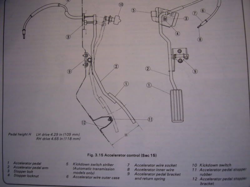

Re: b210 accelerator switch
2009/1/5 13:47
Posts: 78
Kickdown switch :)
Posted on: 2010/1/31 8:19
