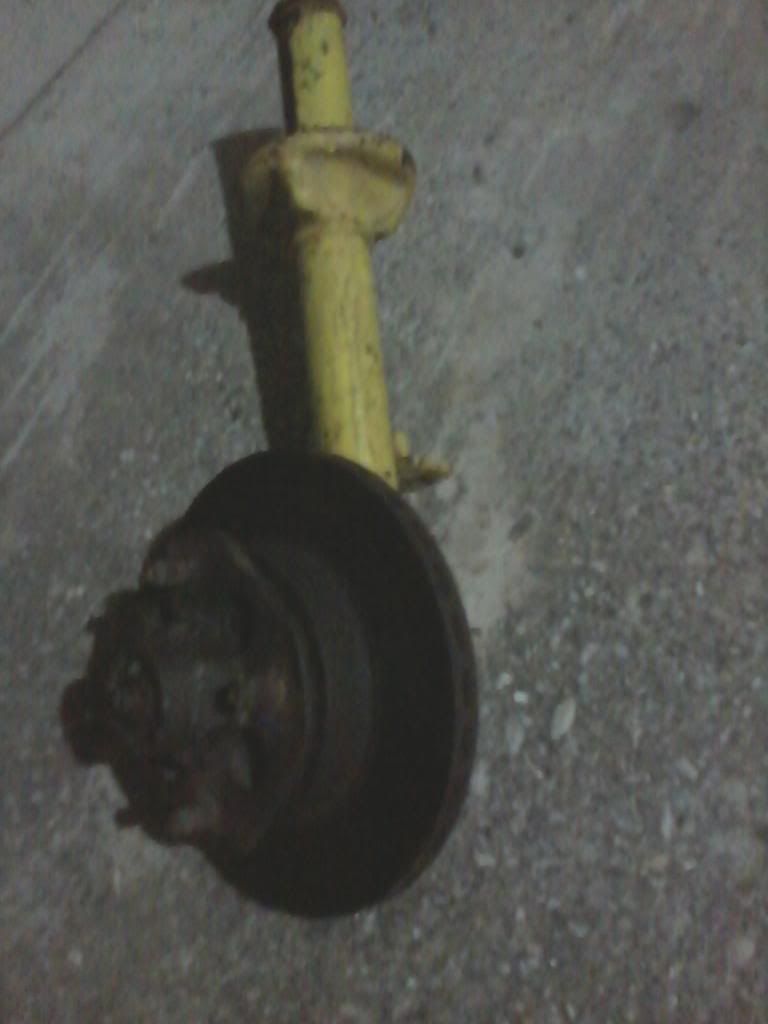

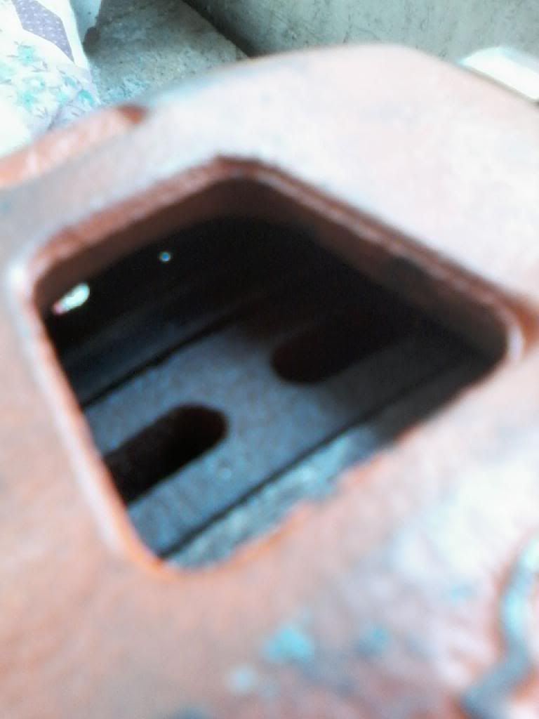

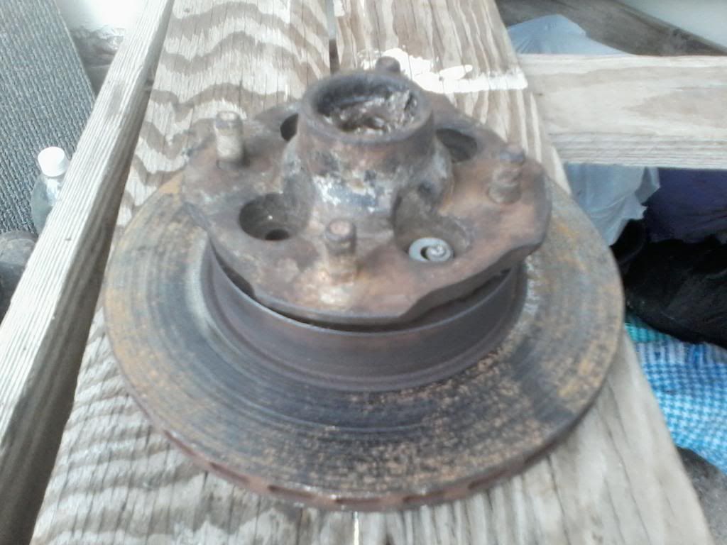

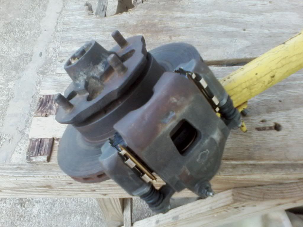

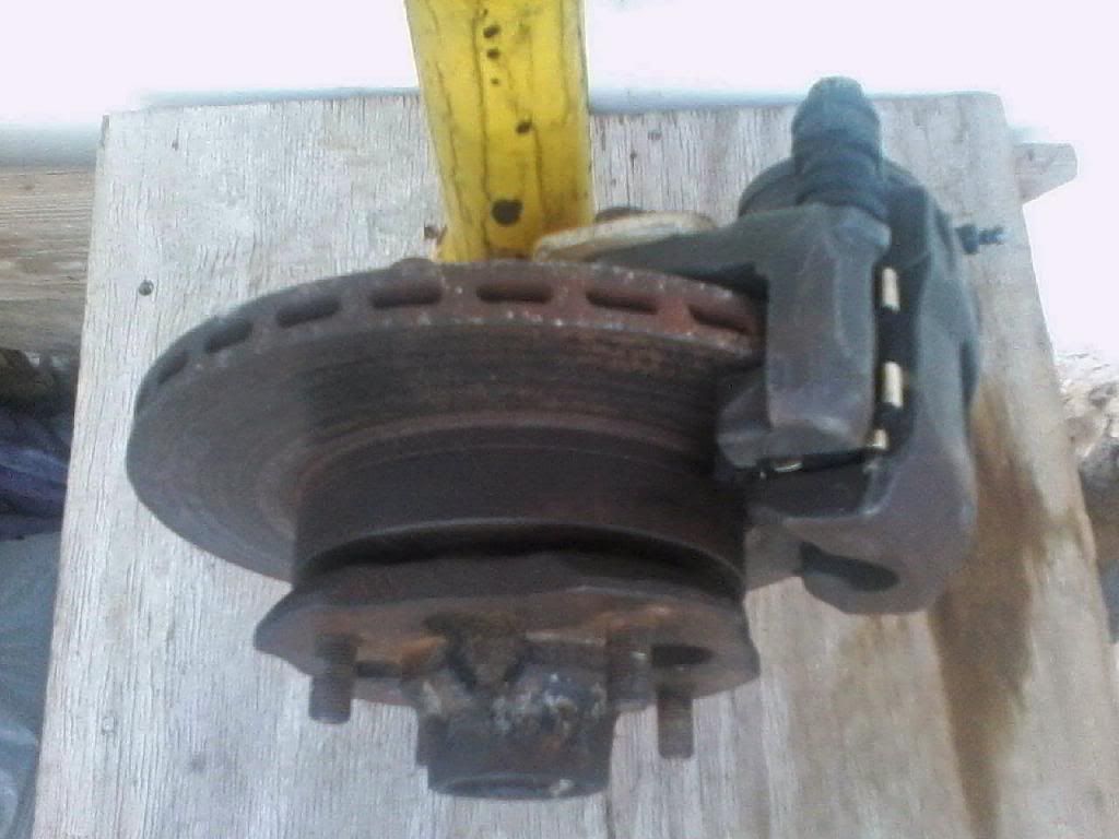

Brake setup is nissan B14 rotor an caliper on b310 struts clears 13'' wheels ventilated.The 1 that i will be using is gonna be cross drilled for extra cooling.
File centre so the disc could slide over the hub.
Centre hub and disc onto strut fits nicely
Had to file the caliper to get teh pads over to cut properly
