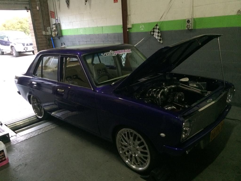

Its a 14psi spring mate havnt Evan been able to get enough boost to open the gate yet lol we were thinking lines and controller but they are fine because we disconnected the bottom of the gate which should way over boost it but still nothing.so were thinking it had to be eaither something blocking the cooler or the cooler itself.will play around this Arvo

No better.made 350hp on low boost (12psi) still can't put any boost threw it.now thinking its a problem with the intercooler or it being blocked and not flowing.ill pull it apart tomorrow and have a look

Just about to whack in some more boost and see what she makes

Oh trust me 320 is plenty for the street lol.its being restricted by about 100hp still on low boost.nah mufflers them self are ok just the pipe it has a weird bit of piping holding the rear muffler on.thats all gone now so just need to modify my gearbox mount then of the run it up again.no tuning needed this time only a power run.it sounds a whole lot sweeter and healthier on its full tune but

She hit the rollers last night only made 340hp ATM on low boost but wouldn't let us feed any more boost into her thanks to a bodgy muffler that restricted it.getting fixed tomorrow then re dyno it sat.proving a solid motor so far
