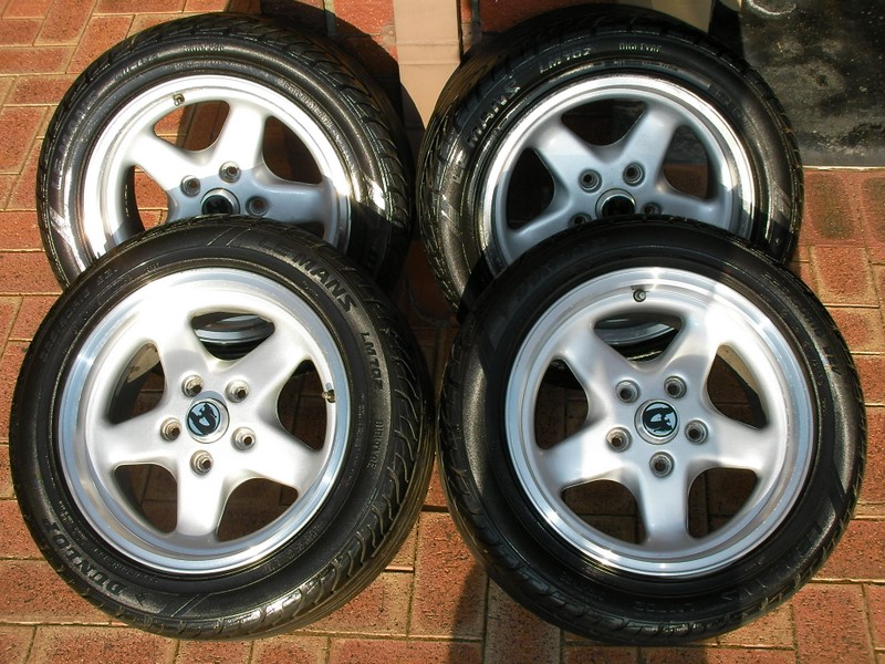

What I've mainly been working on is getting the engine mounts sorted. I'm still playing around with a few ideas but at this point I'm going to use a VW Golf rear intrusion bar (!!) that I've cut the mounting section off. I'll post some photos when I get a chance so you can see what the hell I'm talking about!
I've also been fiddling with the front brakes. At this point I'm going to run VT Commodore calipers and hubs/discs to get the same stud pattern as my Commodre diff.
Getting a bit ahead of myself but I'm thinking of running good old Walkinshaw rims that I used to love back in the day when I liked Commodores. Dunno if they'd work but worth looking at! (Pictured below).
Just need to get a few things machined down to find out if these brakes are going to work. Hope it dos cause I've hacked the $hit out of my Stanza hubs to find out! I need to get the centre of the Commodore hub machined out so it fits over the top of the Stanza hub and then machine down the Stanza hub so it all still sits in the right spot for the disc to line up with the caliper. I'll also need to get 4-5mm taken off the diameter of the disc as the Stanza caliper mounts sit a bit closer to the strut. I'd rather come down a few mm on the disc than stuff around with caliper spacers. If it works man it will stop! The discs are 296mm (less what I take off) and the twin piston calipers have a huge disc coverage. Might need to upgrade the rears but I'll see what it's like once it's working and I've boosted them.
