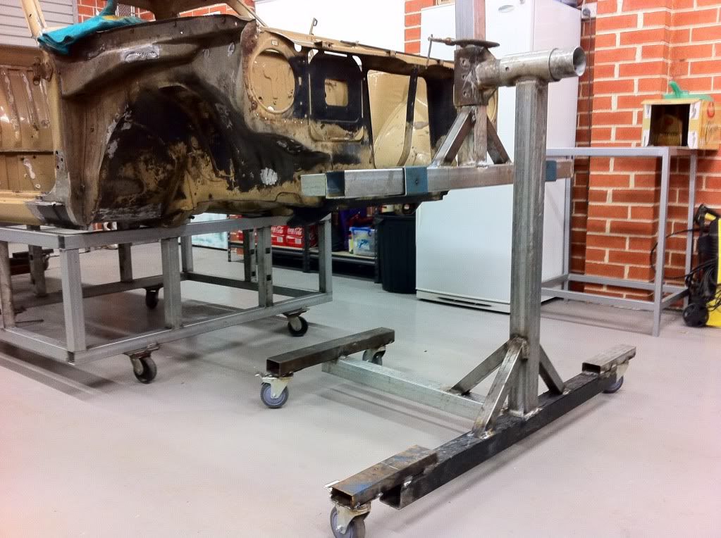

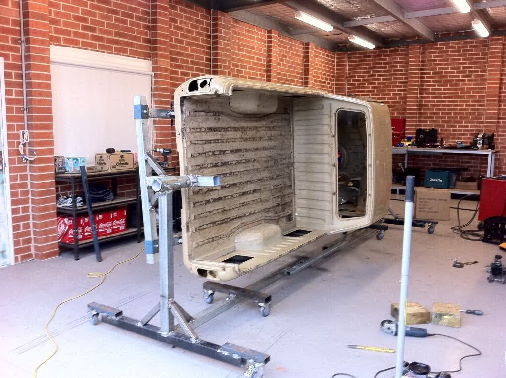

hey guys,
just a quick update, jigged up a rotisserie this arvo at the old mans, hopefully mount it up tomorrow.
also quick question about mounting was going to mount the front to the bumper fixings and rear to the rear leaf spring mount. they a good mounting point?? any advice appreciated.
cheers
rob

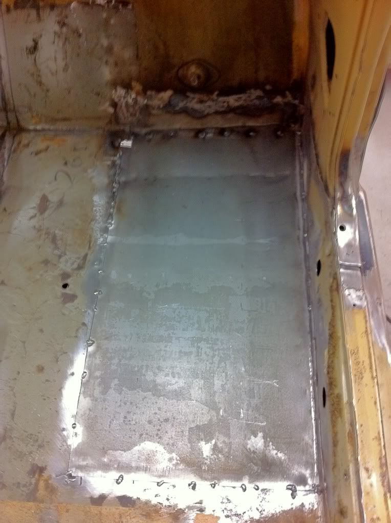

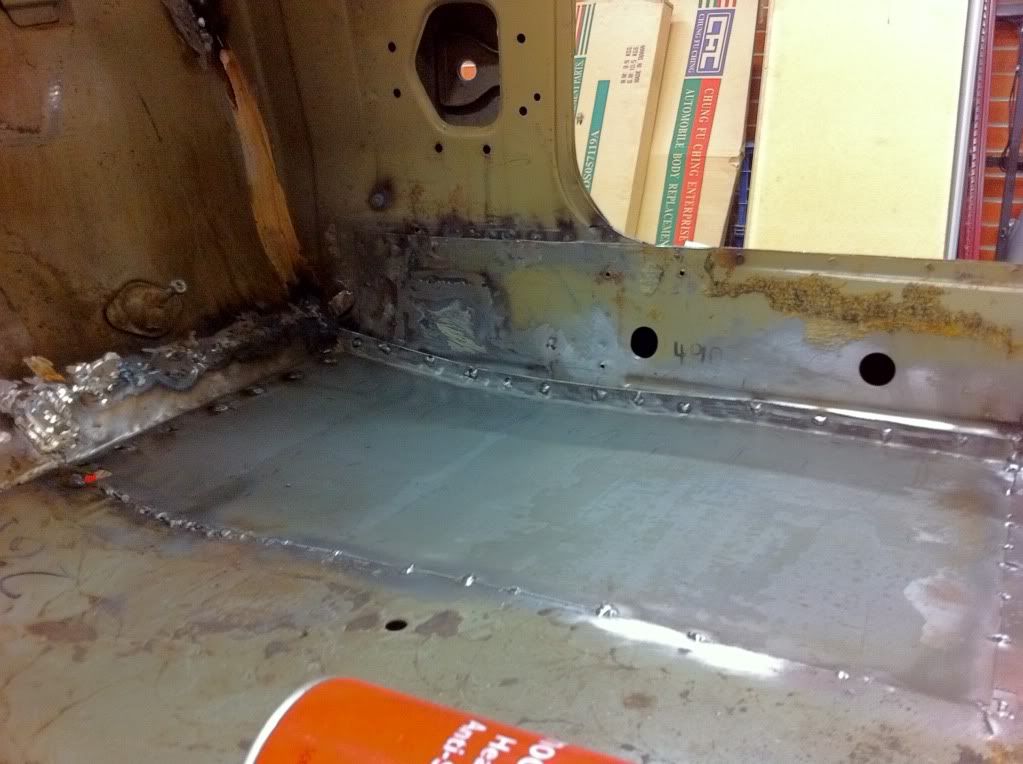

thanks mate, nah im a electrician but worked with the old man a fair bit his a boiler marker, just made the panel from 1mm steel and bent it up on the bench trial and error. dont own a dolly and hammer yet looking to invest in a little set soon.
yeah jack's well worth it mate
cheer
rob
Posted on: 2011/4/25 15:54
Re: Rob's CA18DET 1200 UTE.
2011/3/11 9:43
Posts: 191
got some time today to repair the drivers side floor pan
