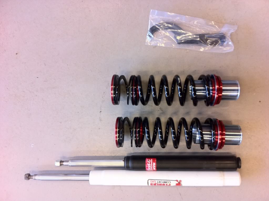

thanks mate, the donor ute was on ebay back in april. ute no longer exist's.
bit of an update.
shortened struts just waiting on camber tops.
also got some advice off shoota to check out a locating system for the rear end, its a watts linkage setup
got this off a EA falcon this arvo borg warner diff which is the same as commodore, fits straight on just need to work out some brackets and adjustable bars.

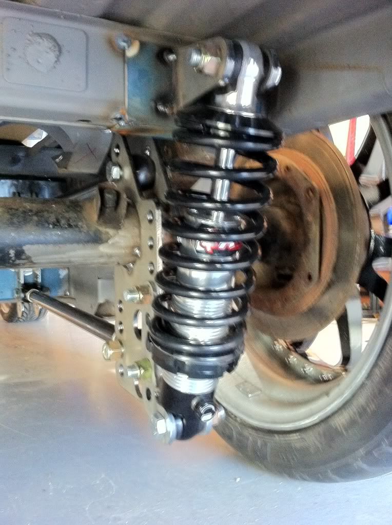

Re: Rob's CA18DET 1200 UTE.
2011/3/11 9:43
Posts: 191
thanks trb012 havent had this many complements on my rear end in ages!!lol
tacked up the brackets and got it sitting on the coilovers, still need to work out what to do with locating bars.
also got some parts to start the front coil overs.(attempt to start!)
(photo quality isnt the best)
