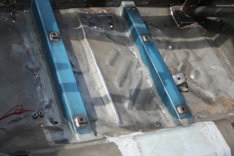

recess 50mm x 50mm box section into the floor and weld it in. Then make provisions to bolt the seat brackets through them and the floor.
there aint no way this bugger is going to move hehe
