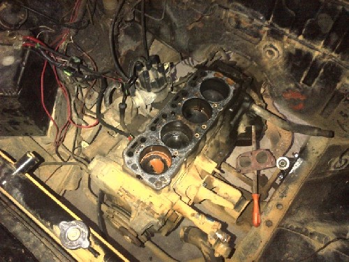

Before and After - My rebuilt A15 just before I sent Lucy off to the Body Shop. Took her for a test run and she ate her first Opel OPC that day...good times =)
Good Starting Point for 500hp right?

I'm not sure if all Bakkies came with H89 heads. Our bakkies all came with A14's far's I remember. The A15's were all import motors. And A15 heads vary wildly. I've had 2 A15 heads, both tiny round-port, without the H-something stamp on them.
The head in the above pics came off my own A15 that I took off when I had another ported. Built the motor first, tried it, and had the body sent for sandblasting and respray since. Motor on the bench has been rebuilt a few times. =P
