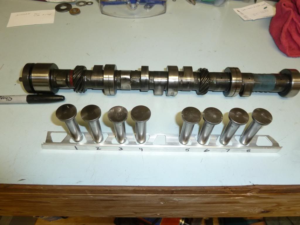

well I guess we all get to learn lessons from time to time, its always good when their reasonably cheap. I just had the pleasure of yanking the A15 out for the 3rd time & installing a new cam & lifters - went flat & dished the lifter face pretty good.
not sure how well you can see but its wiped....
