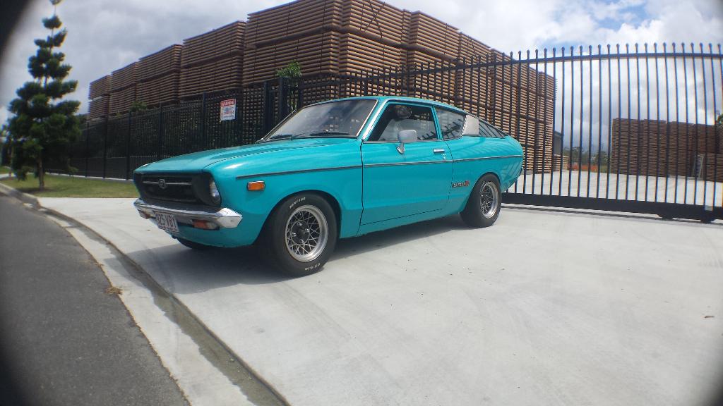

Fitted the strut tops yesterday to finish the lowering job. And trimmed the rear bump stops down to suit the shock travel. Also fitted an engine guardian - temp and volt gauge with programmable alarm levels.

Realised last night this was why I bought new KYB shocks for it 3yrs ago. They're 70mm shorter than the Monroe shocks in it, which I suspect are sedan shocks. So I now have heaps of suspension travel. Might just need to trim the bump stops down to suit, or drill them to make them softer.
Better photo

Fitted the King springs to lower the front. Also did the same castor mod as the 2dr sedan - moved the castor boxes forward 20mm by drilling 4 new holes and cut 20mm off the front. It drove so much better on the wide rubber with the extra castor, I had to do it to this one as well.
Lipped the front guards and trimmed the front lower corner of the wheelarch to clear the bigger, wider tyre with the extra castor pulling it forward.
Flipped a rear leaf to lower the back about 3". I'll need to trim the bump stops and extend the lower shock mount to get some travel back, but I'm happy with that ride height. The front will come down another 30mm with a pair of 1200 strut tops.
