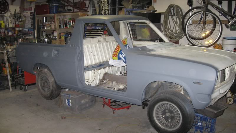

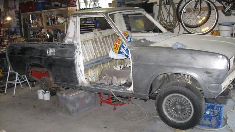

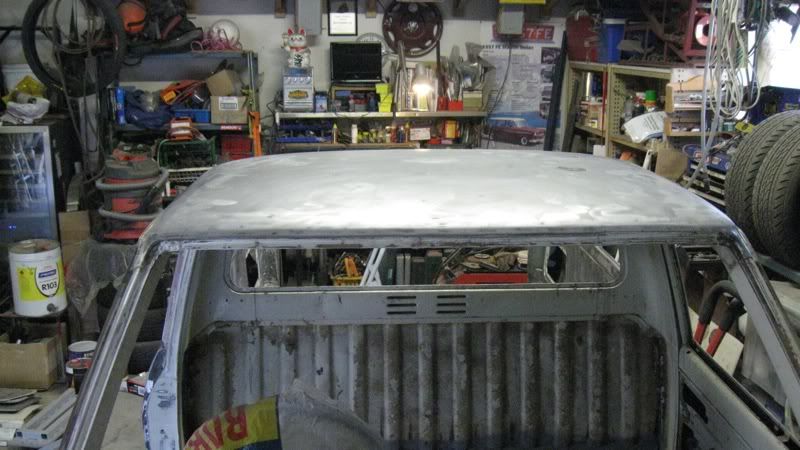

Made a little progress.
Stripped back the old paint and etch primed. priming as I go to avoid oxidation of the panels.
tub stripped back
roof stripped back
ready for paint on one side.. just scuffed the new panel back.
etched on one side (protec etch pro)
Cheers
