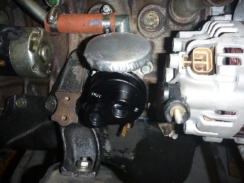

Well I finally got the remote oil filter kit out of the box and made a start.
jpg  REMOTE OIL FILTER04.jpg (95.44 KB)
