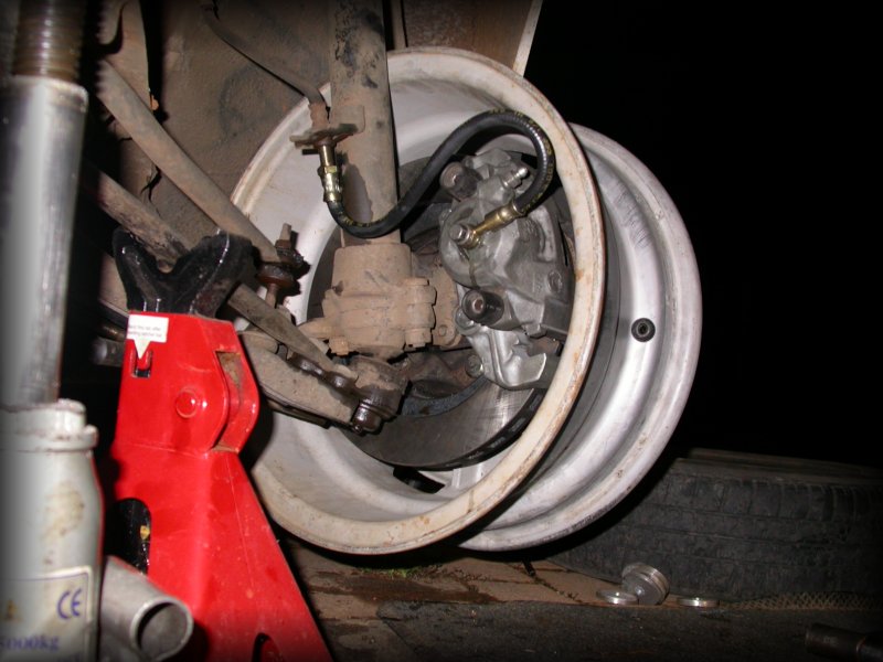

here is what I did, very easy and cheap,
parts.
Disk........: VW Caravelle vented 5 hole 114PCD
Disk mods....: none if you have 15" rims, 10mm smaller on disk diameter for 14" rims
3 holes to handle the 3 studs that don't have holes. one of the existing holes can be used. rim spacing as required......
Calipers.....: Toyota Camry single pot floating.
Caliper mods....: none, just custom made hydrolics....
convertor bracket....: Custom, to use 2 of the 4 holes on the stub-flange....
the calliper can be mounted leading or trailing, depending on where the bleed nipple is situated. Makes for a nice and well thought-up conversion... and it WILL stop you on a dime....

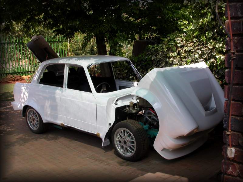

yes, the boot opens up to the side,
I've been building on her, On and Off for the last 12 years.... yes I know... that is pathetic..... but what can I say, life keeps on with these curve balls, and I'm blind in the one arm...
I'll upload some more pics of her now.....
ok done, just go check in the photo album section...

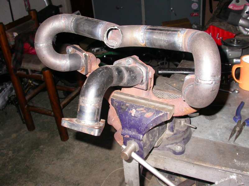

I'm running a Garrett from a Merc VITO Van.
The are a tad bit bigger than a T2
EX-AR= 0.43 IN-AR= 0.45
I am most surprized with this units responce to the A15
here is how I made my manifold.
and on the engine
