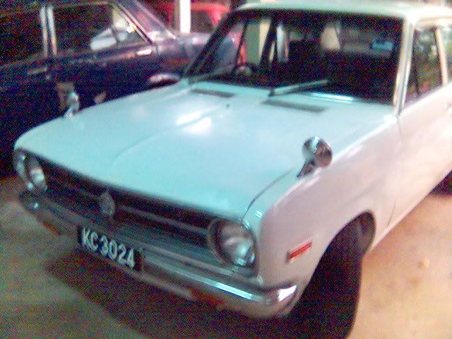

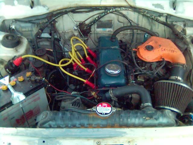

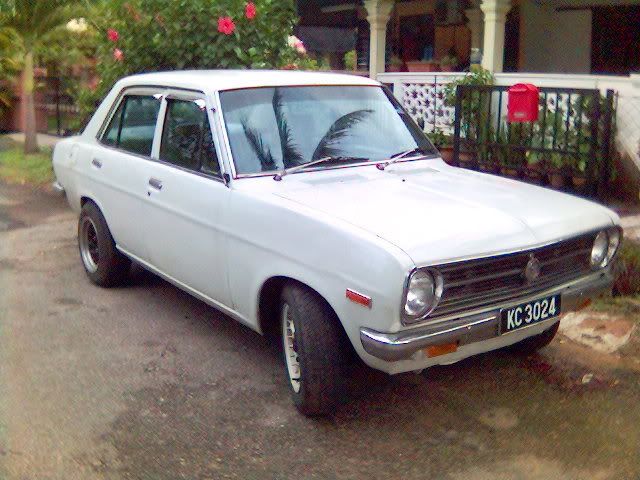

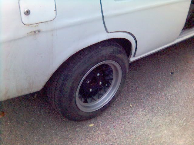

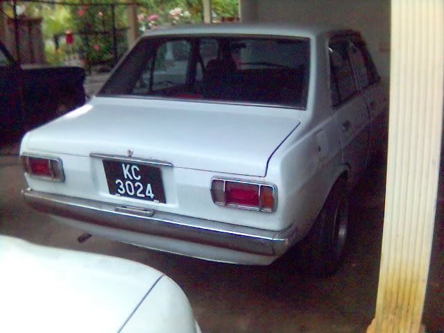

This is my ride...1200 sedan..
2007/10/20 15:48
From Kedah, Malaysia.
Posts: 53
This is my current ride.. still need some restoration...
model; Datsun B110 1970
engine; A15
gearbox; 5speed
wheel; cheviot 13x7" 175/70/13
Steering wheel ; nardi classico
interior; standard except BMW front seat.
exterior; standard
aircond; yes
ICE; n/a
Posted on: 2008/3/30 14:03
