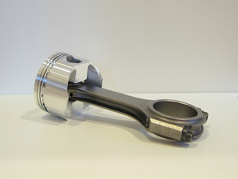

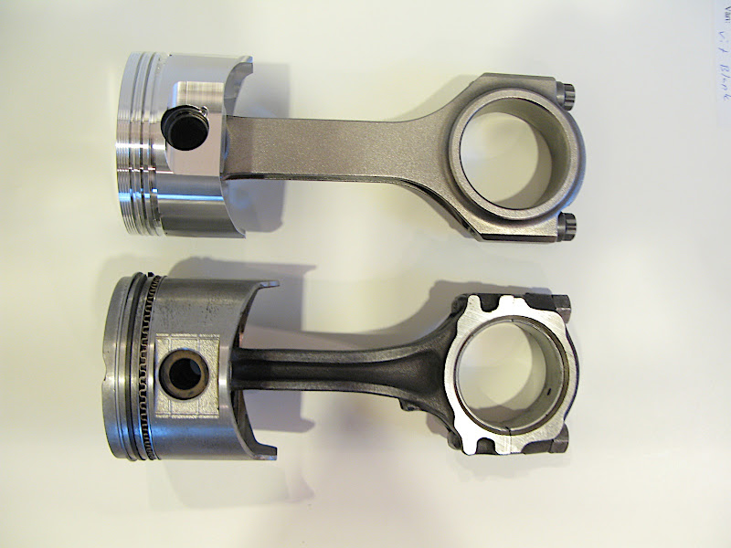

Jmac, thanx for yet another interesting answer.... I will reply to it later! I will try to post a picture of my rods and pistons, finally I got it right!
Here in Finland itīs time to go to bed now, good night fellows!
Marcus
Eagle conrod + Wiseco 79mm
Eagle conrod + Wiseco 79mm vs std A15 conrod + piston
