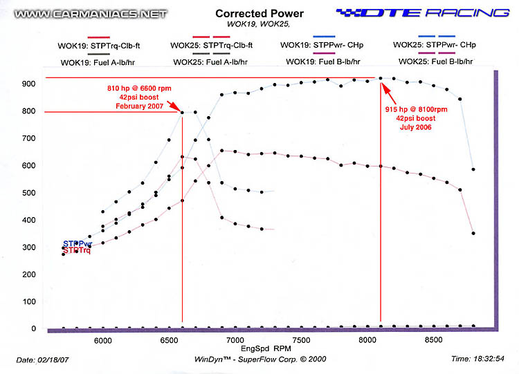

This is so much help, thank you guys! Seems like I have to use sleeves in my engine setup to get the reability that I am aming for. I am not aiming for a high boost engine, rather a high comp engine that produces much power at relatively low boost. I am planning to use a Garret GT25R turbo. One of my mates who has a SR20 in his Cherry/Pulsar producing massive 915hp at 42psi boost hasnīt had any problems with the bottomend since he mounted Darton sleeves in the block, and itīs not o-ringed! www.woken.se/wok/2007/dyno_feb07/bromspapper_ras.jpg He has driven 9,54 on the quartermile......
A 2 litre A14 would be really crazy, in my setup I would get problems with the bottom end and the oil-pan... the 82mm crank fits without problem but there are no space left... I canīt use a deeper oil-pan because of the gearbox sitting underneath the engine! Please keep me uptodate, I will send post and pictures during my project!
M

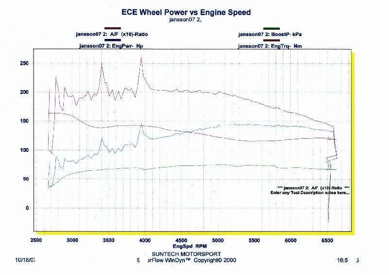

I read that Lemonhead has bored a A14 block to 82mm, thats impressive! Hope he will give me som answers! If he has managed to bore it to 82mm then 79mm want be any problem....
Here is a Dyno chart of my current engine
http://i131.photobucket.com/albums/p3 ... igan/Datsun_100A_dyno.jpg
