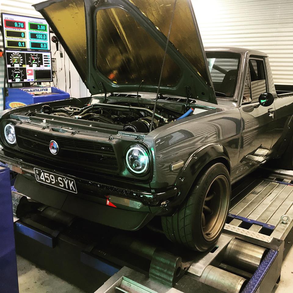

Went back to the dyno and although we set it up for flex fuel im running E85 full time now. Sitting on 34psi and around 525hp at rear wheels. Had to beef up the fuel maps to walbro 023 x 2 (intake o44 basically) that are staged with boost. I reduced the meth nozzle sizes and now run this as an added insurance in the upper boost levels. Still is great for cooling the air temps if nothing else.

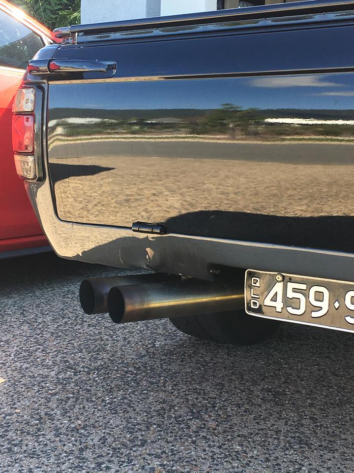

Forgot to mention i plumbed the screamer pipe back in for less hassle from the police. Also threw in a complete new exhaust system with blast pipes for extra jdm points.

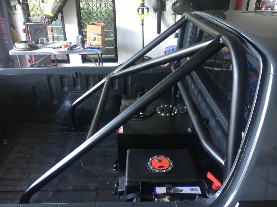

Safety had been playing on my mind and after seeing some images of a fellow owners accident i decided to put a half cage in the rear. Although not full proof it is still legal in qld and adds a layer of safety that was not there before.
