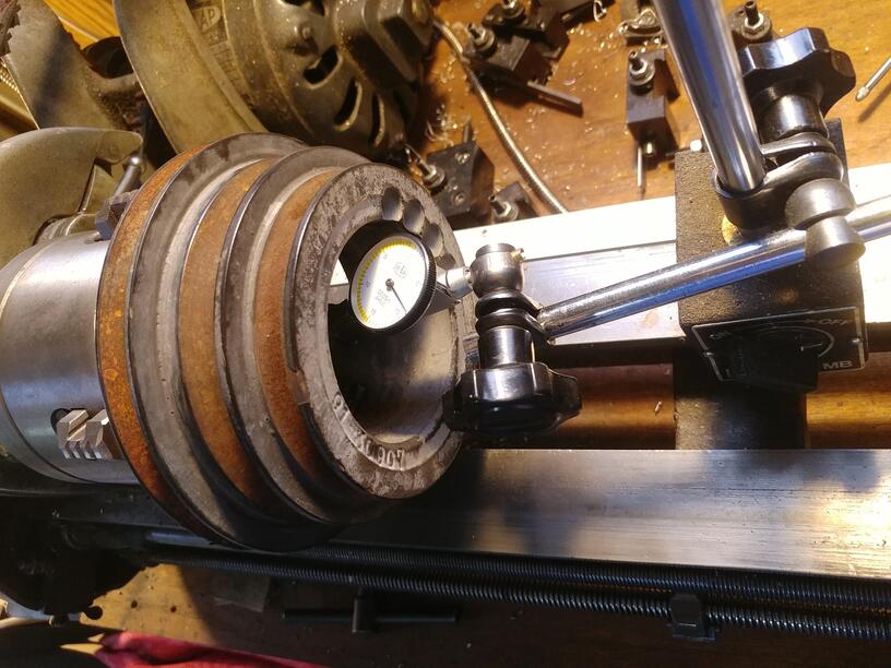

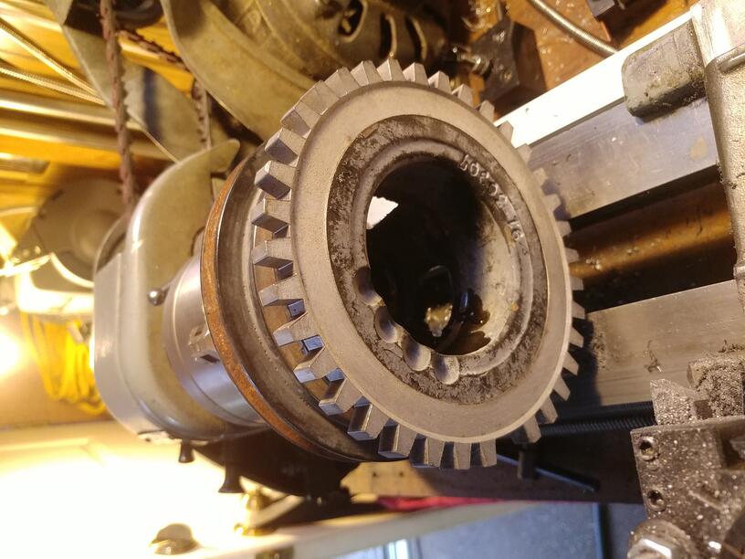

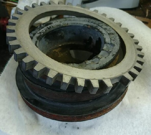

So today I got the impact wrench out and removed the crank pulley fixing bolt. Oh hey I didn't realize that the pulley is essentially a seal. Well, that means I probably can't make one myself, because I was thinking about machining a perfect little crank pulley: just the one roughly 130mm pulley diameter, with a nice flat area I could mill into a 36-1 indicator wheel, and then an extension area for some day if I ever get the energy to try bolting on a Gilmer drive.
The toothed wheel ID is 102.3mm. The smallest pulley OD is 103.4mm. I sure hope it's a good concentric casting...
As this will be spinning fast, I indicated in the bore, not the outside, since that's what I need as the reference point. This was rotten. I had to indicate it in end to end first, and then radially, and I can't see where the indicator's touching since it's way down inside, and the indicator doesn't like the keyway. (It's okay if you can get it close enough that it only drops about 0.01" when it goes off the end of the keyway, but that takes a while to get to.)
But once I got it aligned in the four jaw chuck, it cut nicely and the wheel went on as a quite tight sliding fit. This way it'll hold on well enough that I can get the sensor hooked up and running, and then braze the toothed wheel onto the pulley to keep it solid.
