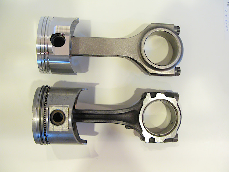

Re: A14/15 turbo~280hp, bore question |
Joined: 2003/1/13 13:39
From Forsby Finland
Quote: I bought the Eagle-rods for 360, I have heard that the Eagle rods have a good price/quality ratio so thatīs why I bought them! A funny thing about weight, the Eagle rod weights exaktly the same as the std A15 rod, the wiseco piston is a bit heavier than the A15 std but because the wiseco pin is lighter than the A15 std pin they also weight about the same! So I donīt have to worry about compensation for lighter parts. Marcus
Posted on: 2011/4/8 19:07
I am building a mean Datsun E10 racer  , a15 turbocharged engine, aiming for 280hp....
From Forsby Finland
Quote: dattoman_1000 wrote: I can understand bushing the small pin hole from 21 to 19 if your using Datto based pistons But the crank journal size is 48 whereas the Dat is 44... and rod length is 137 up from 133
Can you explain what mods you did and how to use these rods ?
D is right, the crankpins are the same.....  This picture explains everything, the crankpins are machined for 0,25 bearings to get the right clearance! It would have been possible to use a std bearing but I like it when itīs perfect! I use to say, perfect is good enough for me... and thats why I drive a Datsun Marcus
Posted on: 2011/4/7 19:53
