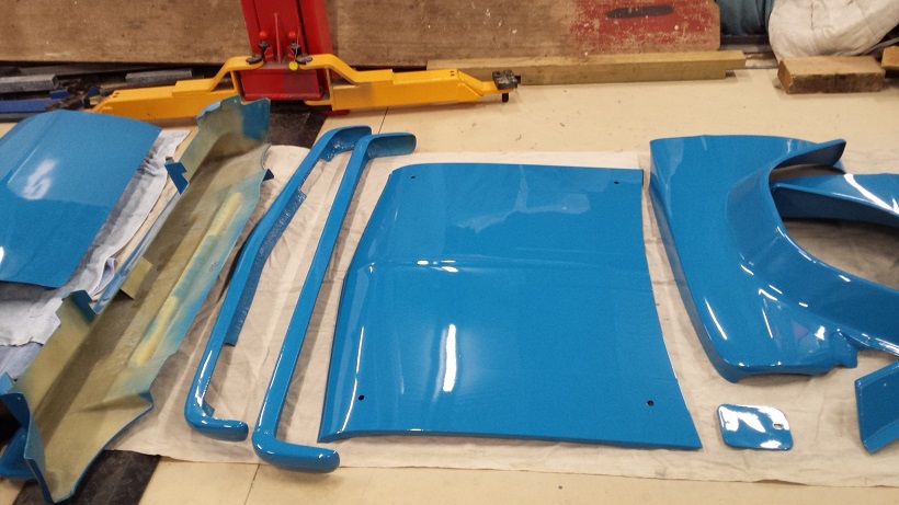

The fibreglass door skins are very light, my guess would
be less than half that of the steel door.
The drivers door is now very flexible and will twist if
grabbed in the wrong spot.
I told the fiberglass guy the bits were going onto a race
car so he made them thin.
The door skins are made from what looks like woven cloth,
where the boot skin looks like normal glass matt.
So now it all fits (or so I thought) it's of to the
paint shop again.

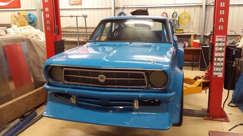

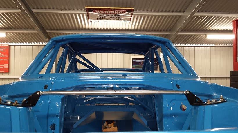

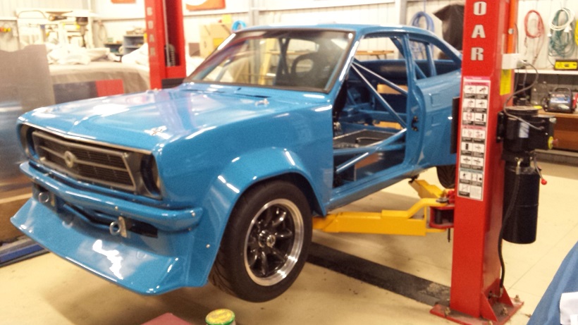

Time to bolt on the panels.
The doors were fitted, but removed again to improve access for in cabin fit out.
Also fitted the strut tower brace. More of MADDAT's stuff,
and the Grill and Aluminium "head lights".

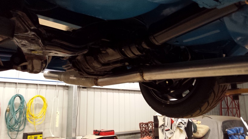

I can't remember the exact order of the next couple of
things fitted to the "blue bastard". . . .
So lets just say it was the exhaust.
I bought a length of straight pipe,
a couple of 90 degree bends and a resonator.
All in 2.5" diameter.
I then hand made a flange from 10mm plate to go onto
the extractors.
The three main things as I saw them were:
1 - to route the exhaust without going under the drivers
seat as its going to be hot enough in there as it is.
2 - to try and keep the exhaust as straight as possible.
3 - I wanted to go out the back of the car to help with the
noise side of things and as it's normally aspirated get
a little bit of back pressure happening.
So armed with a hacksaw and a welder I made this. . . .
