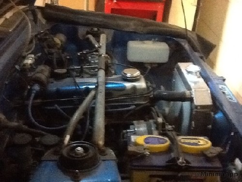

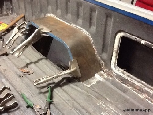

Fitting up the new panels
jpg  image.jpg (95.09 KB)

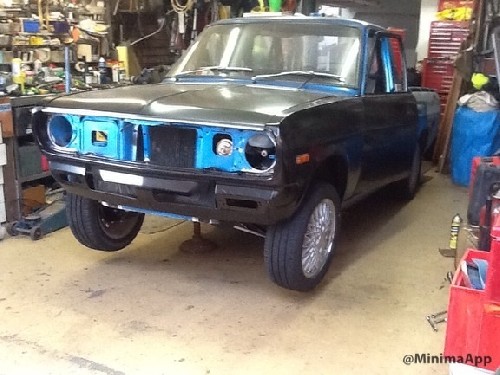

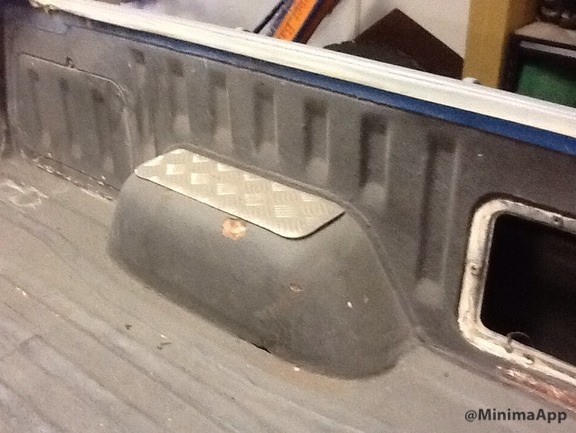

Repairing rusted out rear wheel arches
They were rusted out around lower edge and holes had been filled with sika flex and huge amounts of body filler.
jpg  image.jpg (79.28 KB)
18951_55b19c46881d0.jpg 576X433 px
jpg  image.jpg (93.00 KB)
18951_55b19c5b0e2bf.jpg 576X433 px
jpg  image.jpg (93.33 KB)
18951_55b19c71dcd92.jpg 576X433 px
jpg  image.jpg (80.81 KB)
18951_55b19c8204bd7.jpg 576X433 px

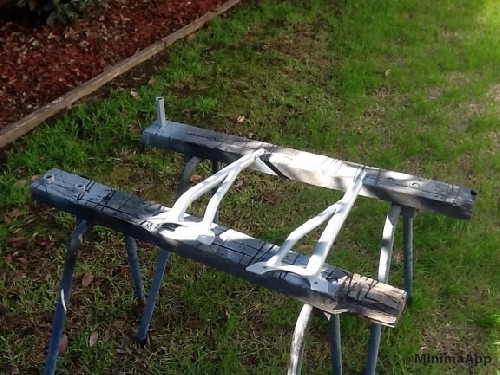

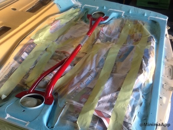

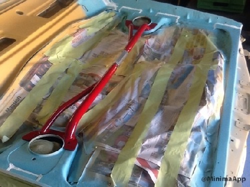

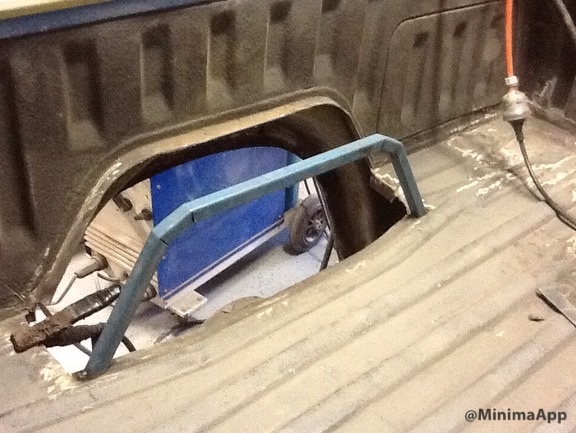

I got sick of doing rust repairs.
Had some pipe and a turn buckle laying around.
So I made a strut brace up.
jpg  image.jpg (86.05 KB)
18951_55b19d69b2250.jpg 576X433 px
jpg  image.jpg (116.98 KB)
18951_55b19d79debea.jpg 576X433 px
jpg  image.jpg (87.86 KB)
18951_55b19dc2037da.jpg 576X433 px

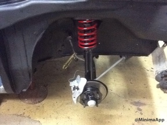

Rebuilt the calipers and a tidy up of the front end

Yay, a classic aussie-style buildup right down to the TRX wheels.
I like the wheel arch fix, looks good.

Thanks D
Spent a lot of time cutting, grinding, wire wheel and welding.
Just about had enough of removing rust.
Almost done!!!!
