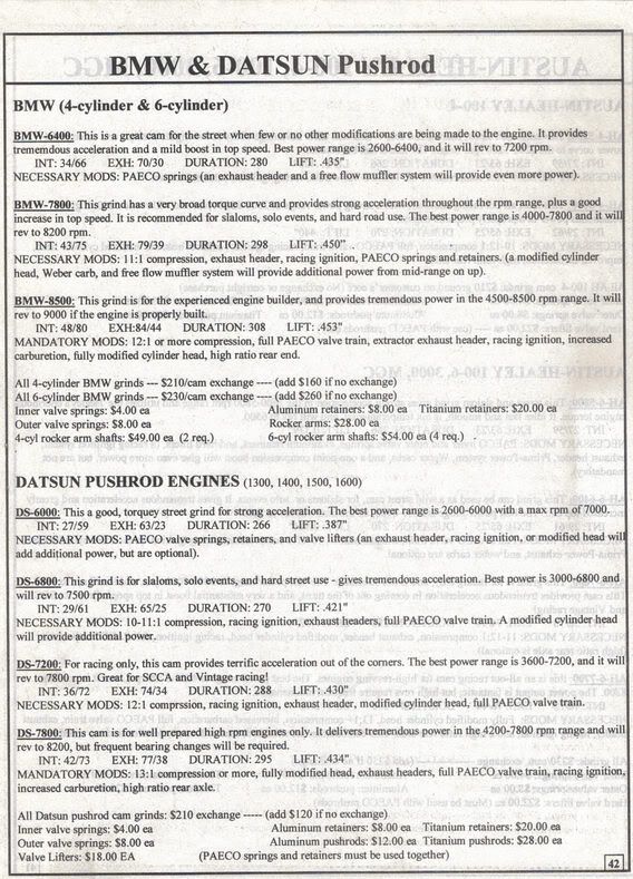

Thank's for correcting me there Rallytwit , been a while since I have made an order

[/URL][/img]

[/img] screw it !!

this?

yep, that one, thanks . I'll get the hang of this one of these days.
