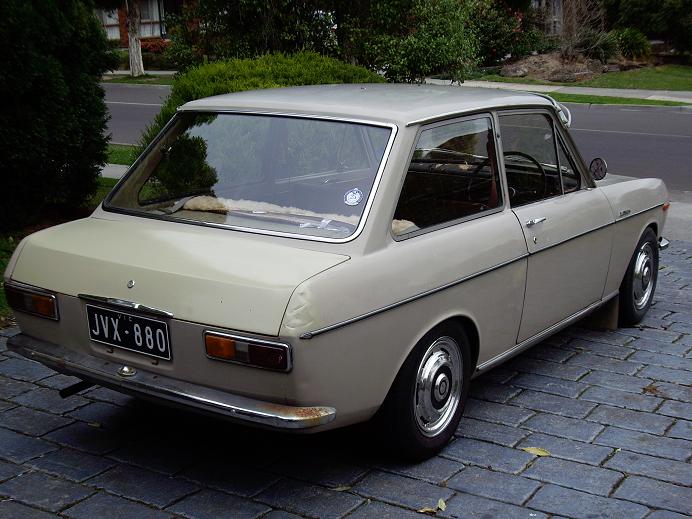

datsun leaf sprung sedan's and coupe's have three leaves, wagons and utes have an extra one additional to these that is very thick. all i did was remove the two leaves that weren't the main leaf and added the leaf from a 1200 ute. the 1200 ute thick leaf is the same thickness as the two i removed just that it is flat rather than bowed. had to cut half the bumpstop off to ensure a nice smooth ride
the front i just cut the bump stops clean off and removed 5ish mm from the end of the leaf and bob's your uncle.
rides nice and smoothly still, no spine compressing done at all. both of these tricks came from mopar. negative camber is coming for the front soon.
DM: i have kept the uniting church sticker on the passenger side window and the 25 years membership RACV sticker on the rear windscreen.
