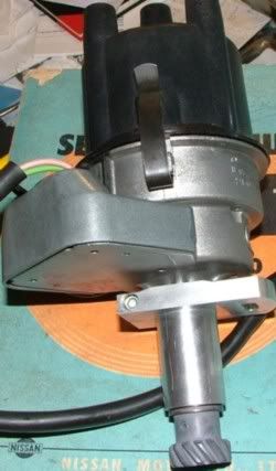

Have a look at your unmodified distributor, then compare it to the photo. If you feel that you can duplicate this, then go for it. Keep in mind that this one has a billet hold down bracket.
This is one of Datrats products & the workmanship is superb.
Scroll to the bottom of the page in blofly's Datrats link for more info.

The distributor pictured both here & in the earlier post is an Australian made Bosch electronic unit that was used in the 1984 model, Series 2 Nissan Bluebird [910] in Australia. This was the last hurrah for the L series engine & the only model to use an electronic distributor.
The unit pictured both earlier & here is a commercially supplied unit, available through Datrats in Victoria. There is a bit of work involved in these units as not only is the conversion undertaken, but the distributor is supplied with the internals restored to new condition.
This is a good value & good quality product. It is in effect, zero timed. Duplicating this in a home workshop environment is beyond the scope of most people.
This is how my very ordinary looking donor distributor came back to me from Datrats. I couldn't pick it from new, yet it was a very sad looking wrecking yard refugee when I sent it to Feral for conversion.
