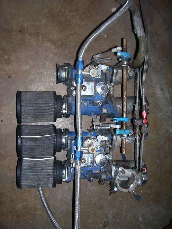

Hey guys, I'm not really into the datsun thing but I have this intake and sidedraft setup that was given to me. I was told it's off a nissan or datsun. After about 3 hours of researching the internet...everything kept leading me here. This place seems like a killer website with all the info & tech. I've searched the tech & archives, but I can't seem to match this intake setup with anything.
There are no numbers or letters stamped or cast into the intake or carbs. The carbs only say Mikuni and Solex. No numbers or anything else. It is plumbed for a n2o fogger setup as well.
Anyway, if any of you guys might know what this setup is for, I'd really appreciate some information. Thanks a bunch.

Mitubishi or Gemini

Where are you located? Maybe its for a KA24? The runner spacing looks right for that engine. Its definitely not for any standard 1200 engine.

there are two engines that have this type of manifold pattern, nissam e15 pulsar 1984-1987 or z18 z20 nissan (navara late vanette import) go to your local spare parts store and compare the manifold to the intake patterns in their acl catalogue repco would be best choice good luck!

this is definatly a Z series intake manifold
eg z16, z18, z20, z22, z24
ports look large though
cant comment on the ka24 but think it is very similar

illl back up the "its a Z series"
