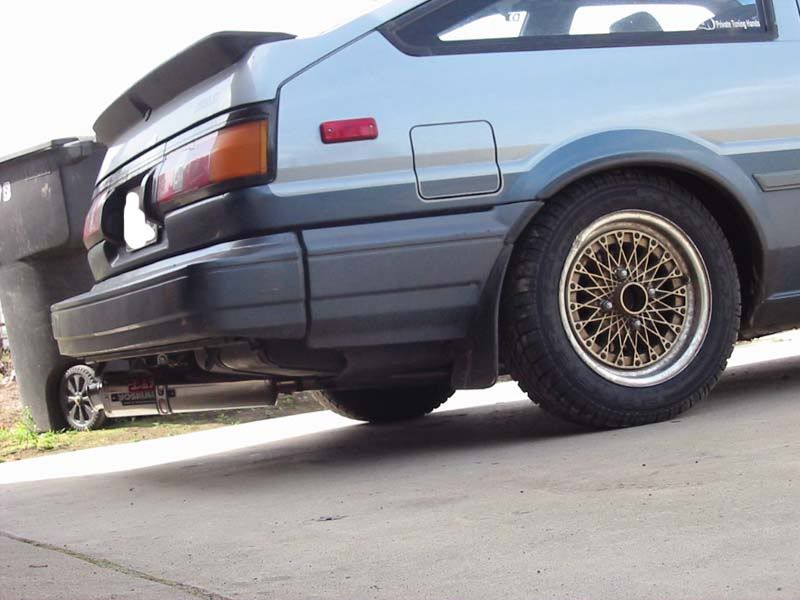

Motorcycle mufflers seem to have worked well for several club4ag.com members:
cycle muffler on a corrolla
Its too bad there isn't much room on a 1200 between the leaf spring and gas tank. An oval bike muffler might work.
Think about it, nowadays even a 600cc superbike makes over 100 horsepower at nearly twice the rpm of our Datsuns. A stock superbike muffler would provide plenty of flow and people are tossing them on ebay for $30 to $50.
