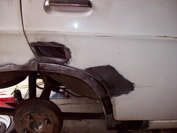

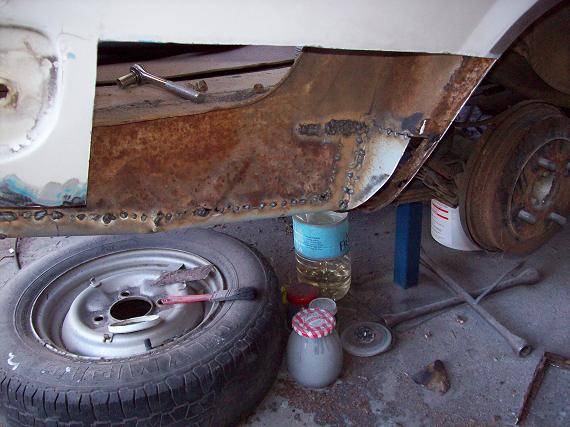

sikdatto1200 Posted on: 2007/2/26 8:06
Well i quit my job this last week (sick of being treated like ####) so ive had plenty of time to work on the datto. Ive found a heap of rust under a ton of bog (about 20mm+ thick in the rear quarter so im replacing it!
Heres the section i cut out of the boot were the seal runs, ive got a good section from another car to weld in
Here is a pic of the doors inside, i coated it in rust convertor then primer and sound deadner, should do the trick
The door, new metal welded in now
Door progress, try the dent next
The $300 MIG, works great for thin stuff!
The sill repair was very involved in getting it to fit correctly but im stocked with how it turned out, mmm fresh non rusty metal
This was the old rear quarter, no rust had brocken through on the outside body panel, probably because the bog was soo thick
The inner quarter rust ...
And the beginnings of repairs, its a very involved area to repair
The outer rear quarter took a lot of trimming but eventually will fit like this
So i guess as far as rust goes, times what you can see by 10 and thats about how much there might probably be! Think i might wear pants when welding next time though my legs copped all the splatter, ill update when i get much further.
