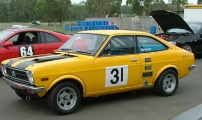

<----First up we have the very attractive 1200 coupe of Jeff Hanson. A great lookin' ride you have there Jeff, it's no 'ar farsed effort at all. It sounded really strong & fast, but it developed an oil problem with some of it making it's way onto the suspension area.
It's just a minor development problem Jeff, & I'm sure that it's an easy fix.

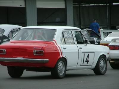

<----- This is the little car that can. Aiden's car is being steadily improved as time & money allow, & the change of wheels with a bloody good set of tyres have made a big difference. This in turn has allowed an improvemet in times, & the skill level is steadily improving. It is stored in The Boss' workshop, so it couldn't be in better hands.
Oil fitting problems were overcome, but a suicidal gearbox part spoiled the day in the end.
I think that we should all get acustomed to seeing this one as with any luck, it will be going places, .... fast.
