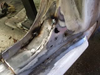

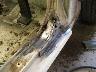

Re: L16 1200 Sedan
2004/7/15 12:10
From Adelaide, Australia
Posts: 3931
Bit more progress, im getting the hang of the welder a bit more, still comical. I had to do this twice, the first time I didnt add enough metal, I should of bent up a larger peice, also went through the first peice with the air belt sander.
