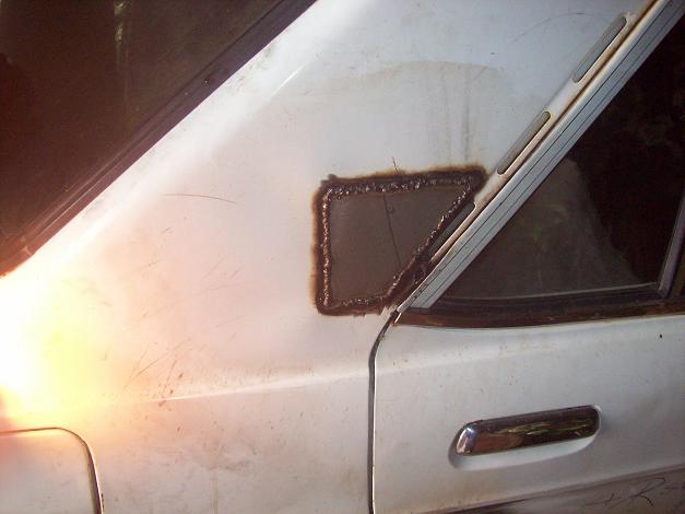

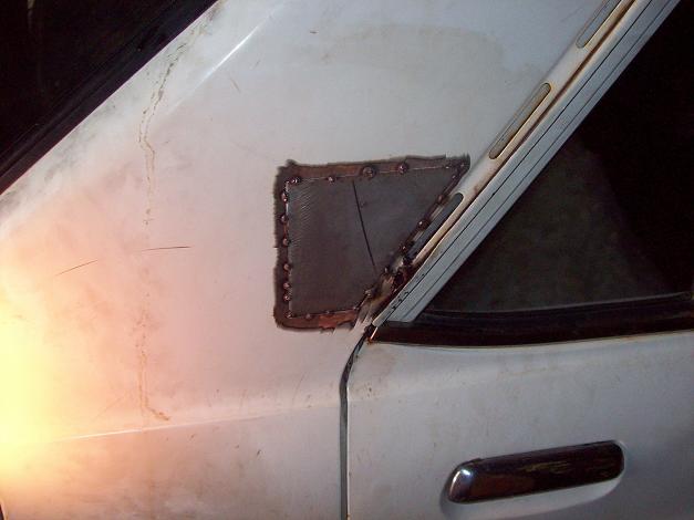

I started by doing the C pillar ?, made and welded a patch. Ive just learnt how damn easy it is to get warps in the panels, i was doing maybe 2 or 3 quick tacks at a time then cooling with wet soaked rag, still made high spots in the 90degree corners, looks like 45s would def be the go as they didnt warp. I managed to knock them down a fair bit but still a couple of low spots the filler will cover. Then i did the boot seal area. Heres some pics from today.
The patch tacked in
The patch welded in

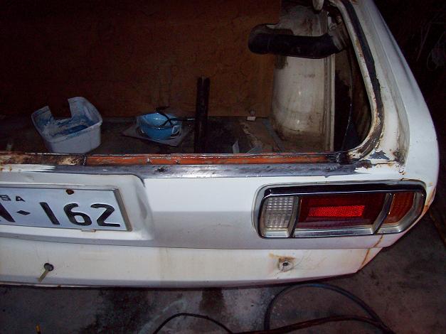

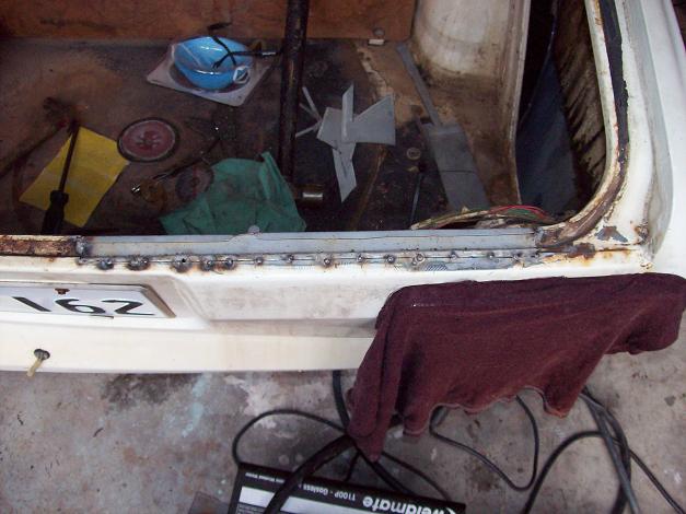

New metal tacked in for boot seal area
Welded in, didnt warp at all too easy!
Weld ground back, few spots will need filler but the bulk of it will be ok with primer.

You can shrink the high spots a little with the mig. Get your wet rag handy. Put a weld right in the middle of the high spot, A quick zap so you get like a spot weld red hot and then quickly cool it with the rag. It will shrink the high spot a little and make the panel tighter and less like a petrol can.
