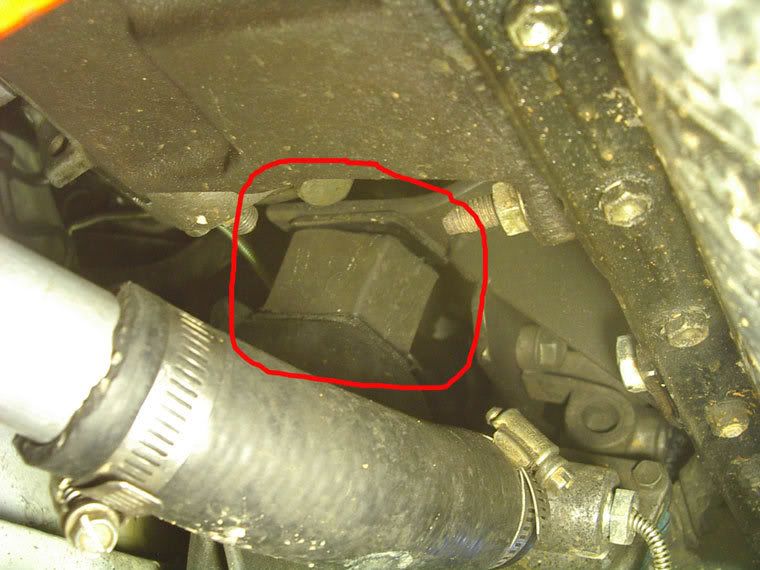

Just found I broke an engine mount rubber, standard 120Y item. I was going to go grab a b310 rubber and stick it in but no-one in canberra has them in stock, and if I have to wait to get one I might as well get something better.
So I was wondering what people have used that has the same bolt size, and is the same height or SHORTER than the original. I have a kelpro cortina rubber on the other side but it is taller than standard.
Part numbers would be best but make/model is good. cheers

PhunkDr and i discussed a similar problem a while ago.
This link
should give you some ideas.
edit : a http://datsun1200.com/modules/myalbum/photo.php?lid=4129link
to the sketch that I drew to describe what I was on about.

yeh I have a cortina one in the other side, it is a good 10mm taller than the standard 120Y mount, and I feel that using one on the other side would put the engine on more of a lean.
I like the idea of the bolt though, I'll give it a go.
cheers

A bloke around the corner from me has Jag V8 ones in his 1200, he reckons they are similar to the cortina ones but not as tall.

RB20 ones are pretty close. You need to open up the holes a few sizes, and fold down the rolled edge on the xmember.
