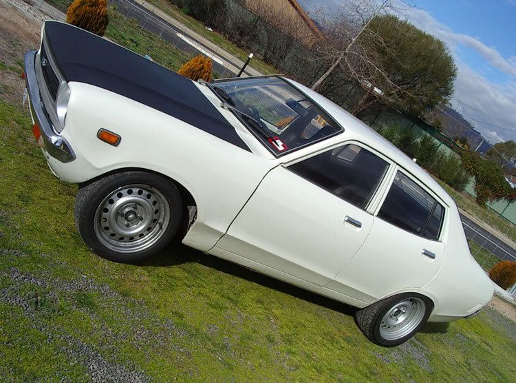

Even if you find what they are (look at ads in fast4s etc) They might not be available in 17x6, and even then you may have troubles with the spring perch. I tried putting +30 15x6 with 195/50 tyres on standard struts in my 120Y and they were very close to the spring perch (and rubbed the strut) I think with those sort of rims you would need large spacers even on a 6" rim to clear the strut. I reckon you should sell the 17s and buy a set of 16s or 15s that fit better. IMO 17s look too big.
My 15s...
