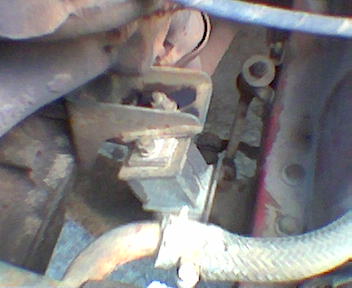

ok cause ive finally got my #### together and putt my engine in today...ive got a 120y engine and i'm putting it in my 1200. my engine mounts don't line up and was wondering do i have to make up sum new engine mounts..??

I may have some made up that will do the trick, I'll check and get back to you
edit: sorry I dont have them anymore, mush have given them away already.
On the drivers side you can use a flat plate with 2 holes in it between the mount and the crossmember, but on the passenger side you might have to make a plate that bolts to the engine block and bolt the engine mount bracket to that in order to clear the exhaust.

dont ya just use a bit of angle
or flat bar

actually best thing would be to try and find a later model 1200 ute crossmember, the one with one mount taller than the other, then you just need the right combination of brackets and it'll bolt up.

yeh thats cool but i got a few ideas ill just make up a bracket up and bolt it on there... cheers
