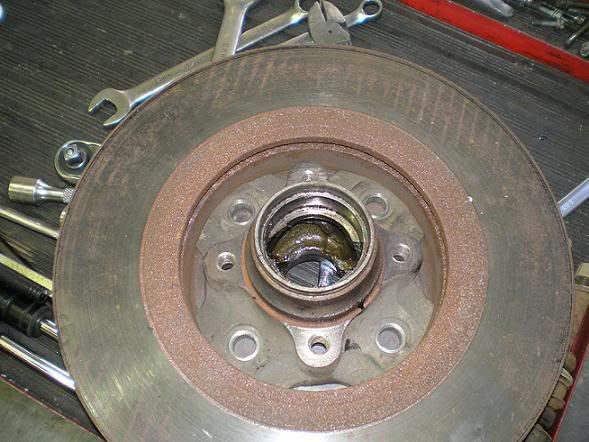

Here is the pic showing the hub machined down to fit inside the rotor.

bad310 this is great stuff, I have read that using 280zx front struts is a very good upgrade for the 310 as you get vented rotors and bigger calipers, would you have preferred to go this way? I like the fact that you have used the 310 strut and modified it to use the s13 rotor/caliper setup, was th emachining work straight forward? Its a shame that r31 diffs cannot be got here in the UK, H190 far more widesprerad but we never got any with lsds.

Min and Jonathan: Yeah I know that there are quite a few struts that fit directly or are able to be modified to suit, but this set up was the easiest route to take at the time and I think it will work quite well.
I didn't do any of the machine work myself, I had a machine shop turn down the hubs and my mechanic (Pizzi Automotive) did the welding and most of the assembly of these structual parts.
