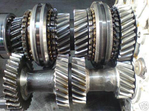

They don't do an "off the shelf" kit, but they will make a custom set. Not entirely sure of the price but something like $600 to 800 per pair of gears.
A 60 series 5 speed g/box that has been converted with three pairs of new gears from Albins Offroad Gears. Ratios 2.66 1.75 1.26 1.00 0.86 Needs one pair of gears replaced. Note that the replacement gears are welded into the cluster
